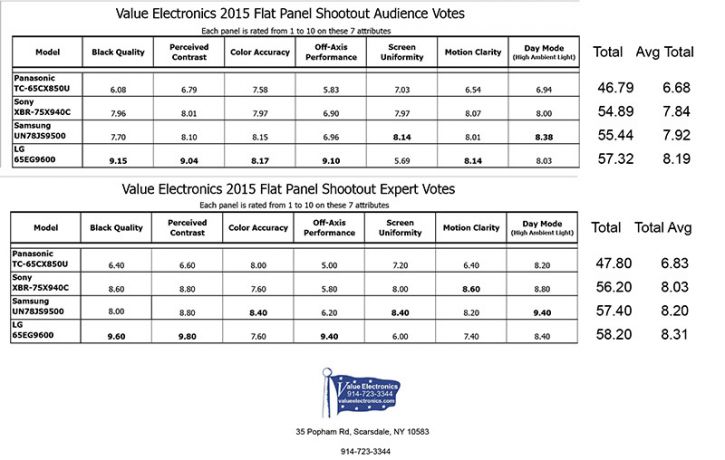

During the shootout, audience members were asked to score the various picture quality elements of each set from 1 to 10 in order to create composite scores for each set. Now the votes are in and the ballots have been counted, and it looks like the LG EG9600 OLED Ultra HDTV took home the prize for the “King of TV” for 2015 with the highest average score. The ranking was the same both for the “expert votes” (TV reviewers, CE journalists and other industry experts) and for the standard consumer votes.
The results are included in the following table:
Having attended the event myself, I must say my own opinions of the sets’ performance in this environment closely tracked these results. While the OLED set did have some issues with absolute color accuracy (which was only visible on select content, and was apparently not noticed by many voters), motion clarity and image uniformity (again, only with certain content), its deep inky black levels, excellent perceived contrast and outstanding off-axis performance gave it the edge in overall picture quality over the LED/LCD sets.
The Samsung and Sony sets — which scored quite close to the LG set overall — performed better with overall image uniformity and motion reproduction but couldn’t quite match the black level performance and perceived contrast of the OLED. Also, all three of the LED/LCD sets performed poorly for off-axis viewing. While the Panasonic scored lowest in these particular tests, it also did produce a pleasing image in person, and sells for a fraction of the cost of the competition so it’s still a worthy contender for your Ultra High Def dollars.
