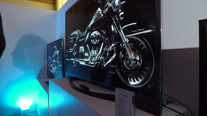

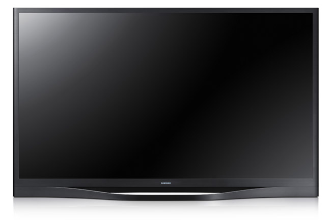

At CES this year, while 4K and OLED were the talk of the town, it was a couple of more traditional HDTVs that caught our eye, one of which was Samsung’s F8500 series plasma TV. Referred to by Samsung as the “Ultimate Contrast” television, the F8500 features improvements in overall brightness as well as deeper blacks compared to its predecessors. Put together, this means the set offers impressive contrast and can perform well even in brightly lit rooms.
We were able to spend some quality time with the F8500 this week at a private Samsung event in downtown Manhattan and found out a little bit about what makes this marvel of technology tick.
The brightness (luminance) enhancement comes primarily from a reduction in thickness of the plasma cell wall which surrounds each of the three sub-pixels (red, green and blue). The subpixels make up each of the 2 million plus pixels on the TV. Because there is less of a gap between each sub-pixel, this means each sub-pixel can be larger and can generate more light. This feature is exclusive to the F8500 series. Also, the discharge gas formula of the plasma itself has been tweaked this year to allow greater output. This also contributes to the brighter image.
As for the black level improvements, Samsung engineers attribute this to the newly enhanced “carbon nano” filter called “Real Black Pro” which coats the glass of the plasma screen. This isn’t simple “window tint” that makes everything darker, but a specially designed formula and screen structure which passes light outward from the TV transparently while absorbing ambient light in the room. This allows the blacks to stay dark without being washed out by ambient room lighting. If you have bright lights directly behind your viewing area you will see some light reflected by the screen but it’s fairly diffuse and greatly minimized compared to a plain glass screen. Improvements made this year to the filter’s efficiency (its ability to pass light to the viewer) actually improve brightness as well, so the filter contributes to both the better blacks and brighter whites.
While some other 2013 plasma models include this filter, the version in the F8500 is an enhanced version (hence the “Pro” designation) making this another feature unique to the F8500
