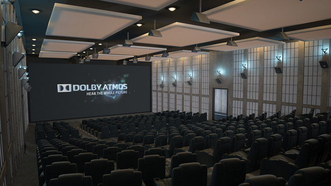

Dolby made a big splash at this year’s Cinema Con show in Las Vegas unveiling a new surround sound system for movie theaters. It’s an object-oriented platform that can support up to 64 discrete channels of sound. The system, known as Dolby Atmos expands on traditional surround formats by offering not only more side and rear surround channel options but also height channels to give theater goers a more immersive and three dimensional surround sound experience.

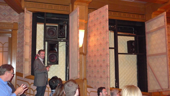

Earlier this week, we had a chance to hear Atmos in action at Dolby’s screening room in San Francisco in a 26.3 channel configuration and we were impressed with what we heard. Editor at Large, Chris Chiarella and I watched (and listened to) a series of clips including the climactic Golden Gate Bridge scene from Rise of the Planet of the Apes remixed in Dolby Atmos, and the sense of spaciousness and presence was breathtaking. A helicopter flying overhead, bullets whizzing in all directions, monkeys making all manner of multi-directional mayhem – all of these sounds were brought to life in a broad, deep (and tall!) three-dimensional soundscape that enhanced the on-screen action. Another complex, multi-layered audio-only clip of an airline flight gone awry (from the perspective of one of the ill-fated passengers) was so realistic as to be difficult to sit still through.

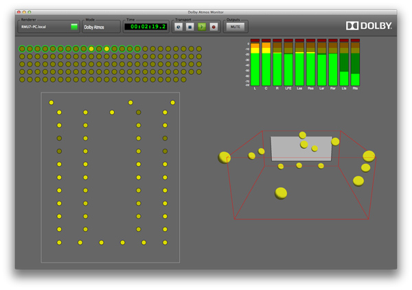

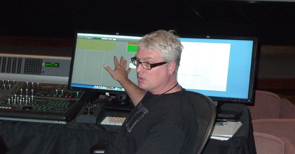

The Dolby Atmos system is object-oriented, which means the mixing engineer can position audio clips, tracks or effect sounds at a point in three-dimensional space with various controls for pans or sweeps or other motion effects all stored as metadata in a dedicated datastream. At playback time, the Atmos decoder positions each sound with precision based on the available number of speakers. This way a single soundtrack can be delivered to theaters whether they have 10, 20, 30 or 64 speakers.
The minimum number of channels recommended for the Atmos experience is 9.1 (a traditional 7.1 surround system plus two height channels), though up to 64 discrete channels are supported. So far, the largest implementation of Dolby Atmos has been the Brenden Theatres in Las Vegas for CinemaCon with a 47.3-channel Atmos system (that’s 47 discrete speakers plus 3 low bass/LFE channels). Although Dolby recommends the use of full-range speakers for all channels, Atmos also includes robust bass management so multiple subwoofers can be used to supplement the bass response of smaller speakers.

According to Dolby execs, the expected upgrade costs for existing theaters will normally come in between $15,000 to $25,000 for a typical installation. This includes speakers, amps, Dolby Atmos processor and installation/training. But Dolby has also stated that a basic Atmos upgrade could be done for as little as $10,000. Atmos is available to mixing engineers as a series of plug-ins for ProTools, the industry standard for movie and television audio mixing. The system supports up to 128 discrete sounds or sound objects ( a 9.1-channel “base” plus up to 118 additional objects) and renders all of these elements at playback time using up to 64 output channels.
