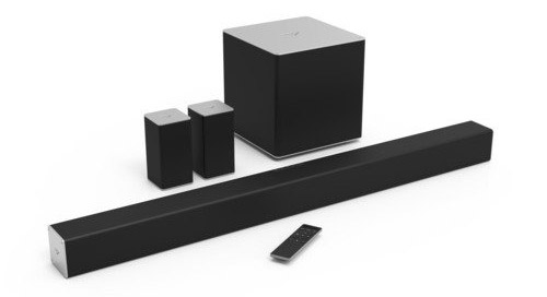

One type of sound bar that does benefit from having HDMI inputs is a true multi-channel surround sound bar. VIZIO and Philips are two companies that make sound bars that come with wireless speakers for the rear channels. This allows you to get true discrete surround sound (with sound coming from all over the room) from a sound bar, without needing a separate receiver. Philips does this with detachable, battery-powered speakers; VIZIO does it with a wireless subwoofer that has speaker outputs for the rear channel speakers. By having HDMI inputs on the soundbar, and connecting source devices directly to the bar, you can be sure to get true 5.1-channel discrete surround.

- VIZIO SB4051 5.1 Sound Bar on Amazon (HDMI input)
