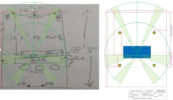

After telling the good folks at Noble Fidelity about my plan to add four ceiling speakers to my basement theater, I was asked to email them a few photos of my space along with a sketch indicating the key dimensions. The people at Noble Fidelity first confirmed that my existing 7.1 system was laid out in compliance with Dolby Labs’ prescribed 7.1 geometry. Next I received from them a scaled diagram of my room indicating Noble’s recommended installation locations for my four proposed ceiling speakers. As I learned in speaking with them, Noble Fidelity’s Atmos system designs take into consideration the key issues of optimum boundary proximity and support in loudspeaker placement; this means they’re careful to ensure that loudspeakers are not positioned too close or too far from reflective surfaces, either of which can be detrimental.

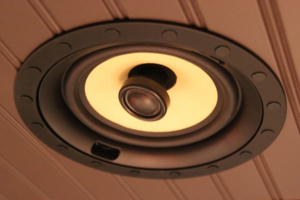

Once we had discussed my current speakers and identified the optimum locations to cut four new holes in my basement ceiling, we settled on Noble Fidelity’s L-65 mk II as the ideal speakers to fill those holes. Compared with the seven LCRS in-walls I was already running, the L-65 mk II features similar-size mid drivers and identical tweeters. This means that, theoretically at least, they should blend nicely with my main speakers whenever overhead sound is called for. (Spoiler alert: they absolutely do!)

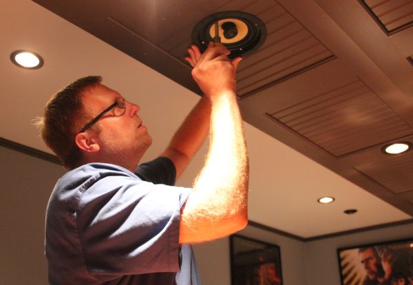

If you install four height channel speakers, the ideal locations for those speakers are going to be in the ceiling slightly in front of and slightly behind your primary seating area. This is what Dolby recommends and, in turn, this is what Noble Fidelity prescribed. Like most ceiling speakers, the Noble Fidelity L-65 mk II comes packaged with a handy cardboard template for tracing its ceiling cut-out hole. In my basement theater, the front height pair posed no problems. The ceiling in front of my sofa is drywall, and there were no unfortunately-located recessed lights to contend with. The rear height speakers were an entirely different story.

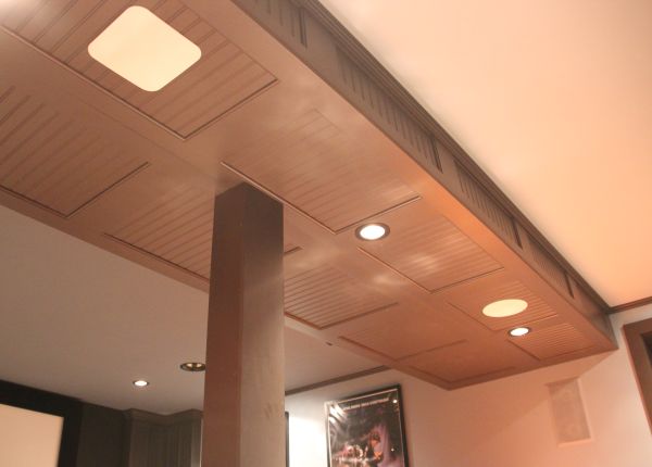

In my basement theater, there is a significant overhead beam and soffit enclosure running parallel to my sofa. This soffit occupies – and lowers – a good portion of the ceiling immediately behind my primary seating area. In other words, it’s precisely where I want to put my rear height speakers. Installing the rear pair in the drywall ceiling behind the soffit would put the speakers a bit further back than I wanted, and I wasn’t sure what the soffit would do to my ability to hear the speakers from the sofa – nothing good, most likely. Thankfully, all was not lost. After this dilemma stalled my project for a short while, a feasible plan eventually emerged, but it would mean some extra work.
I continue to thank Chuck Funk of Funk and Little – the woodworking masters who helped me frame and finish my theater – for his forethought and attention to detail when he built my ceiling soffit. In addition to integrating a convenient shelf for my concealed projector, Chuck convinced me that the entire underside of the soffit should be comprised of removable panels for easier access to wiring and plumbing in the future. And because Chuck integrated the recessed lighting into the panel grid’s cross-pieces, the panels themselves are free of obstructions. They’re also the perfect size to house an in-ceiling speaker.

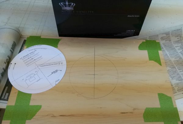

Installing the rear height speakers in the soffit’s panels proved trickier than it looked at first. The panels themselves are made of thin, lightweight MDF. And while the Noble Fidelity L-65 mk II isn’t terribly heavy, the panel seemed incapable of adequately supporting its roughly 6-pound weight. To add some much-needed rigidity to the panels, I glued ¾” thick plywood to the backsides of the two panels in question. This was a process unto itself, during which I had to shave and chisel the plywood in several spots where interior obstructions were preventing the now-thicker panels from lying flat. It wasn’t terrible though and in the end, my two panels were reinforced and I used Noble Fidelity’s template to cut two holes in my new and improved “ceiling.”
The worst part of any speaker retrofit is typically pulling the speaker wire from A to B. My life was made a bit easier here, again thanks to that soffit. Since the soffit is largely empty, it serves as an excellent wire chase and home run to my audio/video closet, which is adjacent to the soffit. Once I had my four ceiling holes cut, it was quick work to run my wires and prep the holes for speakers. Noble Fidelity ceiling speakers feature beefy, spring-loaded binding posts for wire connections and four fast and easy, swing-out clamps to secure the speaker to the ceiling.
One particularly nice touch Noble Fidelity added to their L-65 mk II speaker is giving you a choice of using round or square grilles; both styles are included in the box. The grilles are paintable – which I haven’t gotten around to yet – and they can be easily swapped out thanks to a ring of cleverly-integrated magnets around the speaker’s outer flange. This means you don’t have to pry the grilles out with a paper clip, which can sometimes be a pain. The L-65 mk II’s grilles being so easily removeable also comes in handy when you want to experiment with the midrange and high frequency acoustic compensation switches Noble Fildeility provides. These 3-position switches are largely “set it and forget it” adjustments – but you’ll want to do some experimenting before you set them.

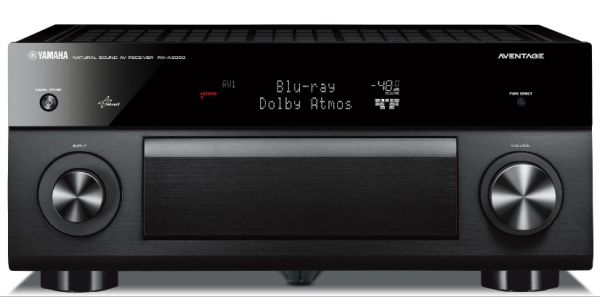

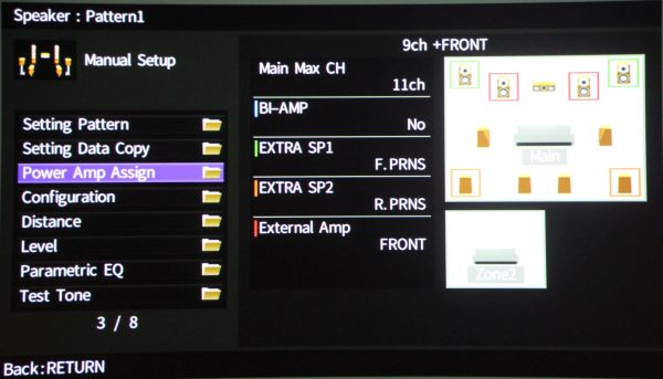

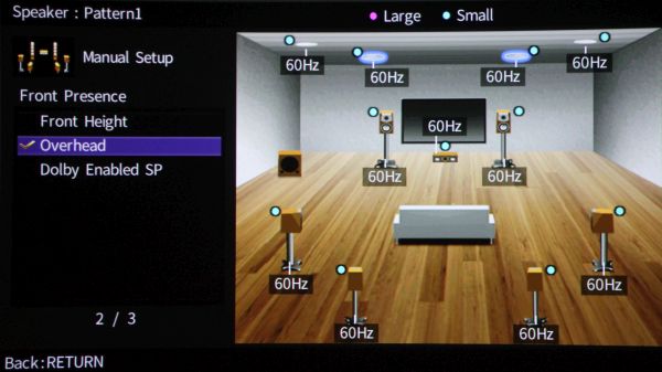

Although this is sure to change, there aren’t many audio/video receivers on the market capable of decoding a Dolby Atmos/DTS:X soundtrack for an 11-channel, 7.1.4 system. The Yamaha Aventage RX-A3050 is one such monster, featuring 11-channel pre-outs, nine internal amplifiers, and fantastic performance. It ought to do nicely given my needs – but it’s still going to need a little help.
As previously mentioned, there are very few AVRs with eleven internal amplifiers and the RX-A3050 is not among them. Yamaha’s RX-A3050 features nine internal amplifiers and supports myriad different speaker configurations, including Zones 2/3 support and the possibility for bi-amping, if desired. If, like me, you’re looking to drive eleven speakers in a single 7.1.4 system, the RX-A3050 gives you a few options over how to use its nine internal amplifiers and, by extension, where you’ll need to add an external amp.
My choice with the RX-A3050 boiled down to whether I wanted to use the required external amplifier(s) to drive the rear height (“presence”) channels, the front AND rear height/presence channels, or the front left and right mains. I opted for the latter, employing a dedicated stereo power amplifier to drive my front left and right main speakers. Audiophiles will argue that a dedicated amplifier is always preferable, so it stands to reason that if you have a high quality stereo amp available, you should give it your two most important channels. In a movie-focused home theater like mine, the center channel is arguably the most important channel, with the front left and right tied for a close second. If music is your thing, the front left and right are definitely your VIP speakers. Although I opted to use an external amp for the front left and right speakers, Yamaha makes it easy enough to change those assignments using an intuitive graphical user interface.

It’s worth noting that when I first received the Yamaha RX-A3050, DTS:X soundtracks were registering as DTS:HD and I was unable to detect height channel sound. Like Dolby Atmos and TrueHD, the height information in a DTS:X mix is layered on top of the core DTS-HD Master Audio soundtrack. This allows for backward compatibility with receivers lacking Atmos/DTS:X support. After DTS:X failed to decode on multiple discs, I paid a quick visit to the Yamaha website where I learned that DTS:X support was actually added to the RX-A3050 via a firmware update. In my eagerness to start listening to these new, immersive soundtracks, I had skipped the step of giving the Yamaha an internet connection. Once I made the connection, software version 1.77 was quickly and easily downloaded and DTS:X was in the house. The internet can be a wonderful thing.
I’ll have more to say on the Yamaha receiver in an upcoming review. The RX-A3050 is one “prime piece of thrust” as Kowalski might say, but during the course of writing this article, Yamaha introduced a replacement model, the RX-A3060. Watch for a review of this new model some time soon.

On a final note regarding the L-65 mk II, suffice to say that is one sweet little ceiling speaker. Once I moved beyond the initial wow stage of hearing sounds directly over my head, it quickly became evident that the L-65 mk II exhibits a wonderful quality of sound and tremendous range, from a robust midrange to crisp, airy highs. They also blend beautifully with my LCRS in-walls. Make no mistake, these are no mere effects speakers; I could easily see myself using these as main channel speakers if I wasn’t already thrilled with my Noble Fidelity in-walls.
