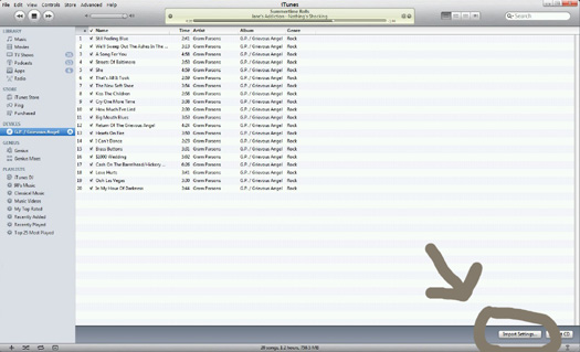

When you first insert a CD, iTunes asks if you would like to import the CD you just inserted. Select “No.” You heard me, just say, “No.”
In the lower right hand corner of the iTunes window is a button labeled “Import Settings.” As you can guess, you should click this.

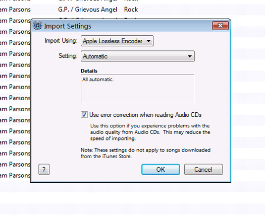

The Import Settings menu has a variety of options. The “Import Using” drop-down menu selects what encoding format you want iTunes to use.
But before we get to those options, make sure you enable (via the check box at the bottom of the Import Settings window) “Use error correction when reading Audio CDs.” This option may take a little longer to rip a CD, but it ensures that every bit of the audio on the CD is captured. This is a must to ensure the best sound quality. There’s really no reason not to enable this, unless you find your drive takes a really long time to rip, which it shouldn’t. If it does, then stop reading this right now and buy a new CD drive. Don’t worry. We’ll wait…

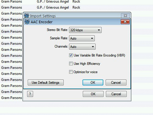

AAC Encoder: Advanced Audio Coding is the default audio codec for iTunes and all Apple products. It is generally considered to be a better sounding compression compared to the older MP3 codec at the same bit rates. If you select AAC, the Setting drop-down menu gives you the option of High Quality (128 kpbs), iTunes Plus (256 kbps), Spoken Podcast (64 kbps), and Custom. Never use the Spoken Podcast option for music. Generally speaking, iTunes Plus will sound better than High Quality, but will create files that are roughly double in size. Each four minute song will be around 8 megabytes instead of 4.
If you chose the Custom option, you can select up to 320 kbps. You also have the ability to change the Sample Rate and Channels. Unless you know what you’re doing leave these as Auto, as changing them will almost always lead to a decrease in sound quality.
The “Variable Bit Rate Encoding” option allows the encoder to vary the bit rate depending on the complexity of the sound throughout the song. I recommend this. It keeps the file size roughly the same, but offers potential increases in sound quality. The “Use High Efficiency” check-box is for low bit rate encodings, and does next to nothing at higher bit rates. The same with the “Optimize for Voice” check-box.
A four minute song at 320 kbps with VBR will take up approximately 10 megabytes. But remember, the higher the bitrate the better (generally speaking), and if you encode your music at very high quality, then it will be unnecessary to re-rip your CDs in the future as you get higher quality headphones or a state of the art home theater system.

Apple Lossless Encoder: If sound quality is your goal, but you don’t have unlimited hard drive space, Apple Lossless is your choice. Apple Lossless, when played back, will be the exact sound you heard as if you played back the CD directly. But unlike AIFF (which boasts the same audio quality potential), Apple Lossless takes up much less storage space on your hard drive or your iPod oir iPhone’s internal memory. A four minute song will take up approximately 22 megabytes in Apple Lossless format.
