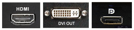

HDMI – the Simplest and Best Option (usually)
If you bought your TV in the last few years, it likely has at least one HDMI input. Many new laptops have an HDMI output. So all you’ll need here is an HDMI cable. Check sizes, though, as some computers may have a mini or micro HDMI output. This may require a specialized adapter or cable. Also, some PCs and laptops have a toggle switch of some kind to enable the external display output. On some PCs, this is accomplished by hitting the function button and one of the “F” keys above the numbers. Check your laptop manual for details.
HDMI Cables:
DisplayPort – Like HDMI… Only Different
DisplayPort is another recent addition to the jack packs of laptops, Macs and PCs. It is similar to HDMI in that it can carry both HD video and multi-channel audio. But, while some computer monitors include DisplayPort jacks, few TVs do. Fortunately you can buy inexpensive DisplayPort to HDMI adapters that allow you to connect to your TV’s HDMI ports. As with HDMI, there are variations on DisplayPort (e.g., DisplayPort mini) so you may require a specially sized cable for your computer.
DisplayPort to HDMI Cable:
- DisplayPort Male to HDMI Male Cable (6 feet)
DVI – the Silent Partner
You also may be in luck if you have a slightly older TV or older computer. A DVI-D connection (DVI Digital) has the same video signal as HDMI. So if your TV or laptop has DVI and the other has DVI or HDMI, all you’ll need is either a DVI cable or a DVI-to-HDMI cable or adaptor to get a computer picture on your TV. Keep in mind, however, that DVI does not handle audio, so you’ll need a separate cable to get sound from your laptop to your TV. Normally this audio output is a cable with a 3.5mm (1/8 inch) plug on one end, and a stereo pair of RCA plugs (usually red and white) on the other. You plug the 1/8 inch plug into your laptop’s headphone jack and the other end either into your TV or your audio system or receiver.
DVI to HDMI Cable and Audio Cable:
Which DVI am I?
One confusing part of connecting PCs to TVs if you are using a DVI connection is that there are actually three different types of DVI connectors. A DVI-A (DVI analog) output is similar to a VGA output (see VGA section below), and can be converted to VGA with a simple cable. A DVI-D (DVI Digital) output is similar to HDMI, but without sound. This can be converted to HDMI via a simple cable or adapter. A DVI-I (DVI Integrated) connector includes both DVI Analog and DVI Digital on the same output, which means it can work with either type of cable. If you’re unsure which type of DVI output you have, check the wikipedia page for DVI (Digital Visual Interface). It includes pictures of each type of connector. Remember, connecting using a DVI connector requires the use of a separate cable for audio.
