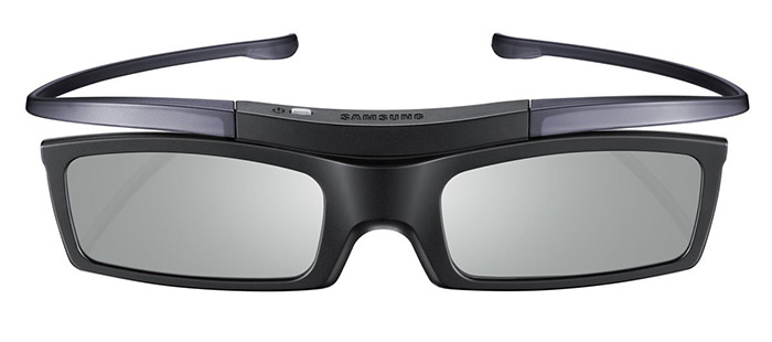

Here are a couple of different Samsung Full HD 3D glasses available on Amazon at affordable prices (as of publication of this article). These should work with your TV as well as other 3D-capable TVs from Samsung and Panasonic:
- Samsung SG-5150GB (battery-powered)
- Samsung SSG-3300GR (rechargeable)

It would be difficult to document all of the glasses and all of the 3D TV models and projectors that work with the Full HD 3D standard, but we can confirm that many popular models do use the standard (some included below). If those Samsung glasses you’re looking at adhere to the Full HD 3D standard (which most do, since 2012), then you can happily use those inexpensive Samsung glasses with your Panasonic TV or with any other compatible 3D TV or projector. I’ve personally tested several different pairs of Samsung 3D glasses with Panasonic TVs, Samsung TVs and Epson projectors and can confirm that they work fine.
The one thing you need to be careful of is that using one brand’s TV with another brand’s glasses may have some minor quirks. For example, if you use Samsung glasses with a Samsung TV and you press the button to synchronize them, you’ll see an on-screen indicator with confirmation of the pairing as well as an indication of battery strength. Using those same glasses with a Panasonic TV, you get the 3D pairing, but you don’t get any on-screen message to indicate success or battery strength.
Also, when you use Samsung glasses with a Samsung TV, turning off the TV or switching it out of 3D mode automatically turns off the 3D glasses, conserving battery life. With some non-Samsung TVs, the 3D glasses remain powered on, even with no active 3D signal being broadcast. If you use Samsung glasses with a non-Samsung 3D TV, then be sure to turn the glasses off (or even remove the battery) after use. This way your batteries will last a whole lot longer. This is a particularly good idea if you don’t use the 3D feature very often.
In terms of compatible glasses, I’ve tested the Samsung SSG-5150GB glasses (2014 model), the SSG-5100GB glasses (2013 model) and the SSG-4100GB (2012 model) with a number of different displays and these glasses adhere to the Full HD 3D standard. I’ve also tested the SSG-3300GR rechargeable glasses with several different displays and found that these work as expected too.
