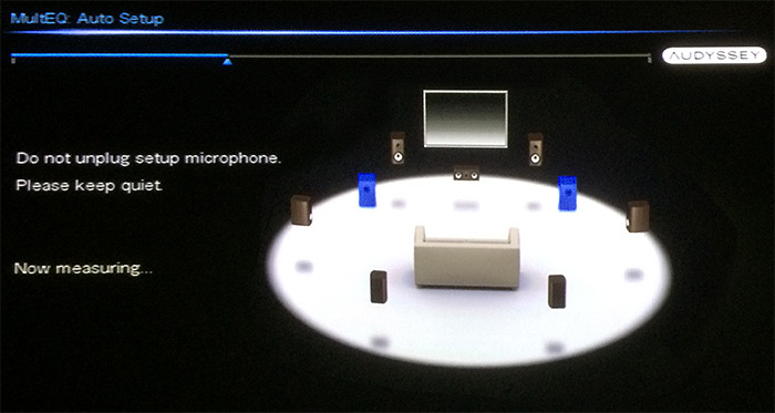

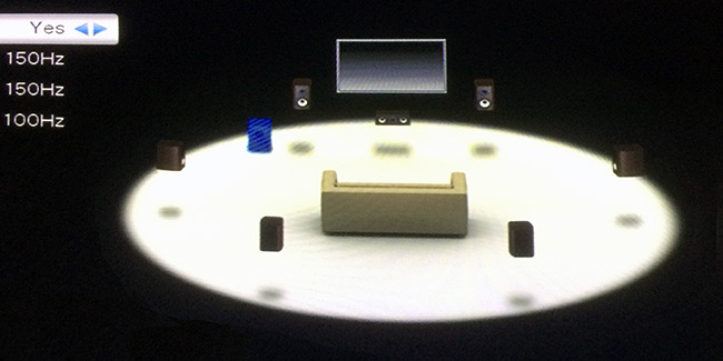

I have an Onkyo TX-NR626 receiver with Audyssey calibration built in. I recently added a second subwoofer so I redid the Audyssey Quick Start calibration to set up the speaker levels again. When running the test, the receiver shows two subwoofers connected, but after the test when I go into settings to adjust the crossover level, it only shows one subwoofer. Is there a problem with the receiver or my subwoofer?
I sent a couple of pics so you can see what I mean.

Thanks for your question. Audyssey’s speaker calibration and room correction software exists in many different flavors depending on the capabilities of the product you find it in (and the price point). Your Onkyo receiver includes Audyssey’s “MultEQ” option. Audyssey MultEQ technically can adjust two subs independently, however the receiver does not offer this capabilty.
So while you may see one or two subwoofers in different parts of the Onkyo receiver’s on-screen set-up diagram, the fact is that both subwoofer outputs are getting the exact same calibration tones and Audyssey is measuring that output only once, in its combined form. On this receiver, Audyssey doesn’t even know that you have two subwoofers connected. This isn’t a limitation of Audyssey per se, but of its implementation in your specific receiver.
Even though your Onkyo receiver has two subwoofer outputs and is billed as a “7.2-channel” receiver, the receiver itself does not offer independent adjustments for each sub. In other words, the exact same signal gets sent to both subwoofers. It’s the equivalent of having a single subwoofer output and using a Y-adapter cable to send bass information to two subwoofers. As such, Audyssey is only able to take a single subwoofer measurement and adjust for that in its calibration and correction routine. This doesn’t mean you can’t use two subwoofers with the Onkyo receiver. It just means setting things up with two subwoofers may be a little more complicated.
