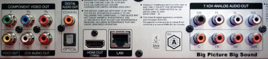

Players like the LG BD390 offer multi-channel analog outputs (right) for compatibility with older receivers.
A better option that would still allow you to keep your current receiver would be to use multi-channel analog cables. Your receiver does have a 5.1-channel multi-channel analog input. Using this, you could get a Blu-ray player with built-in Dolby TrueHD and DTS-HD decoding with multi-channel analog outputs. These players decode the new lossless surround formats internally and send the full quality audio signal over 6 or 8 cables to a compatible receiver (in your case, 6 RCA cables for 5.1 channel sound).
Unfortunately the Samsung BD-P1600 does not include multi-channel analog outputs but the BD-P3600 does. The BD-P3600 also adds WiFi compatibility with an included WiFi USB dongle. Other players with multi-channel outputs include the Panasonic BDP-BD80, LG BD390, OPPO BDP-83, Sony BDP-560 and Pioneer BDP-320. Your can read more about these (including links to full reviews) in our Blu-ray Player Buyer’s Guide.
