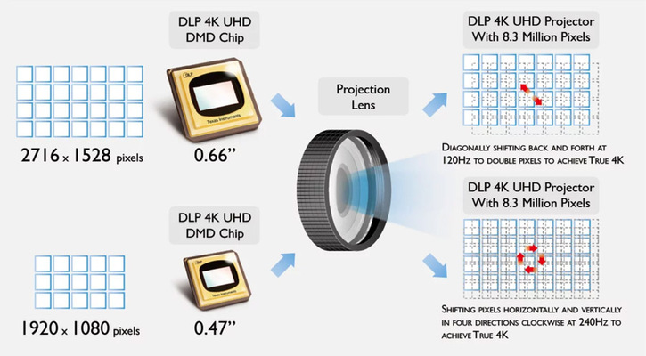

With projectors, the impressively large image you see on screen comes from a tiny imaging device. A DLP (Digital Light Processing) micro-mirror device, LCoS (Liquid Crystal on Silicon) chip or LCD (Liquid Crystal Diode) chip may be as small as 1/2 inches diagonally. Zoom lenses in projectors enlarge the images produced by these devices into the big picture we see on screen. Attempting to pack more pixels into such a small device can be a real challenge. And when companies do create denser, more detailed imaging chips, they typically cost significantly more than the lower resolution devices. So projector makers have developed a technique which allows existing imaging chips to display more pixels on screen than are physically included on the device itself. This is done by shifting the pixels on screen to make more dots: “pixel shifting.”
On a traditional projector, each pixel on the imaging device corresponds to a pixel on the screen. It’s a one-to-one ratio. When pixel shifting is employed, each pixel on the imaging chip is shifted very quickly by a microscopic amount. This allows the chip to display one pixel at the original location and a different shifted pixel next to it (or technically, diagonally adjacent to it) a fraction of a second later. The result is twice the number of visible pixels on screen: twice the detail.
With faster, more advanced optical components and processors, each individual pixel can be shifted three times for a total of four times the number of pixels displayed on screen. Using this technique, a 1080p imaging chip can reproduce full 4K resolution and a 4K chip can reproduce full 8K resolution. Epson calls this type of pixel shifting “4K PRO-UHD quad-phase, dual-axis pixel shift technology.” Though they’ve recently simplified that to “4K Display Technology” (thank you, Epson). JVC calls their latest version “8K eShiftX.” Texas Instruments (makers of DLP technology) call theirs “True 4K DLP Technology.”

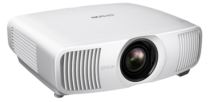

Epson offers two different types of pixel shifting. Epson’s standard pixel shift, which is sometimes called “4Ke” (4K enhanced) or “4K PRO-UHD” shifts each pixel once diagonally, thereby doubling a 1080p LCD chip’s effective resolution. But twice the resolution of 1080p is still only half the resolution of 4K. So while these 4Ke projectors support 4K sources, and many also support HDR (High Dynamic Range), they aren’t reproducing the full detail of Ultra HD 4K content. Meanwhile Epson’s dual-axis pixel shift does support full 4K resolution. Sadly, Epson’s marketing material makes it a bit tricky to determine which Epson projectors use standard pixel shifting and which use quad-phase, dual axis pixel shifting. Their LS800 UST projector uses standard “4Ke” pixel shifting while their LS9000, LS11000 and LS12000 long throw projectors use quad-phase dual axis pixel shifting.
In 2025, Epson continues to use the term “Pro-UHD 4K” to refer to any of their projectors that use pixel shifting, but they have begun using the term “4K Resolution Technology” to identify the full 4K dual axis pixel shifting that results in actual 4K resolution on screen. So if you see an Epson projector that is labeled as having “4K Resolution Technology,” then know that this projector supports full 4K resolution thanks to dual axis pixel shiting.
