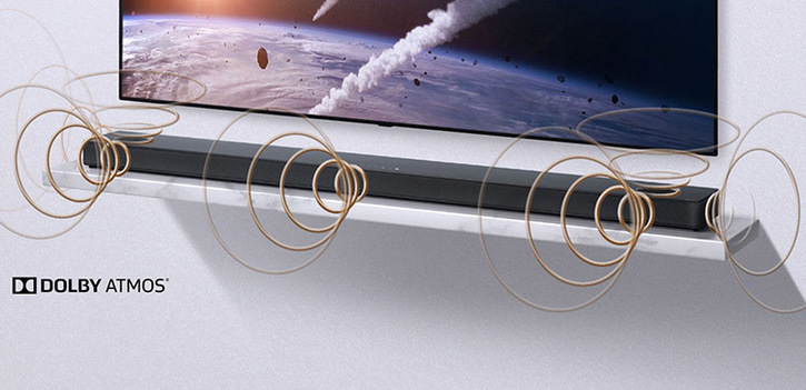

Can a Soundbar Do That?
While a receiver with dedicated speakers will generally give you the best results, some companies are making soundbars that provide a pretty realistic immersive surround experience. New soundbars from companies such as Yamaha, Samsung and LG are designed to bounce sound off both the side walls and the ceiling in order to create a “5.1.2” immersive surround sound experience from a single soundbar and dedicated subwoofer. These types of systems can be effective at generating an immersive soundfield, but for best results, the listening room must have regular wall and ceiling surfaces that are reflective enough for sound to bounce off and reach the listener’s ears from the right directions.
In general, you will get better overall results from a receiver or preamp/amp system that uses dedicated height speakers installed on or in the ceiling, but for those in smaller spaces or in apartments where running a lot of additional wires can be problematic, these reflective and virtual surround sound options offer a viable alternative.
