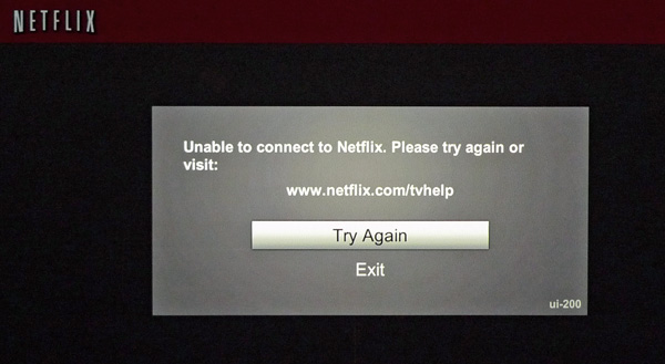

I have a Panasonic Blu-ray player that has Netflix on it. I set it up a few months ago and it has worked fine for streaming movies and viewing my Netflix instant queue. But recently I’ve started getting error messages when trying to access Netflix. “Cannot connect to netflix, please try again.”

- “Cannot connect to Netflix, please try again or visit Netflix help website”
- “Unable to connect to Netflix. Please try again or visit www.netflix.com/tvhelp [Try again/Exit] – ui200”

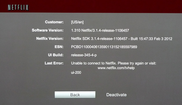

But there is a way to break the link to your Netflix account from the actual device itself. To do so, get into the Netflix screen on that device (or the Netflix error screen, as the case may be), then using your device’s remote, hit the following buttons:
up, up, down, down, left, right, left, right, up, up, up, up.

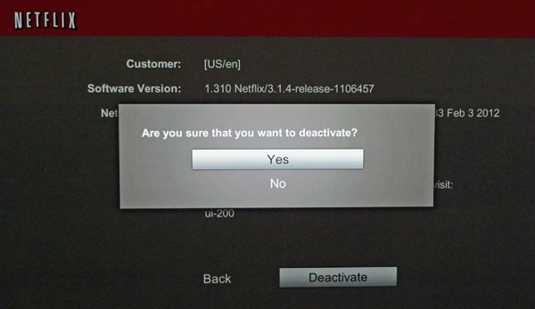

This should take you to a Netflix system information screen with the option to Deactivate the player from Netflix.
Select the “Deactivate” button to remove this device from your account. To be safe, you might want to shut the player down and re-start it.
