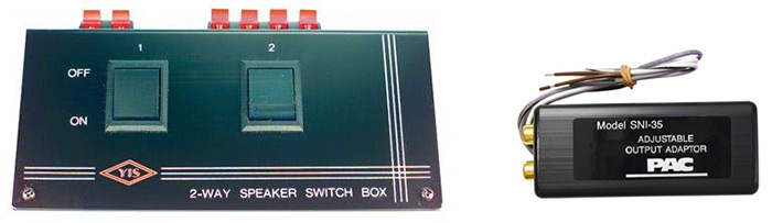

To minimize that lower output you might consider getting a simple 2-way speaker switch and a line out converter. Connect the two-way speaker switch to your main left/right speaker outputs. Connect one pair of speaker outputs from the switch to your main left/right speakers and the other output to a line out converter. A line out converter converts the speaker level output from the switch to a line level so you can connect it to that second amplifier to drive all your remote speakers. These converters are typically used in car audio installations but can also be used at home. The total additional investment for this solution should be under $40 for both pieces. I’ll include links to the products on Amazon below.
If you go with this option or the previous one (connecting the switch to the Pioneer’s speaker output) then be sure to re-run your MCACC speaker calibration after you hook up the speaker switch. There is likely to be a drop in volume to the main speakers with the switch in-line so running the MCACC calibration will correct for this and will adjust all of the surround speakers in the main room to match the levels of the front speakers.
