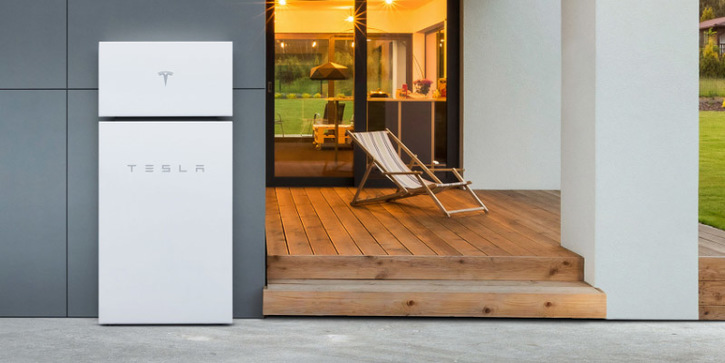

Also, having a hybrid system means you will still have power during a black-out or system outage and you won’t have to install an expensive fossil fuel-powered generator for emergencies. I should mention that in 2021, Tesla began requiring stationary storage be included in any solar power system you buy from them. So if you have an older Tesla solar power system, it may not have batteries, but since 2021, all solar panel and solar roof systems sold by Tesla include at least one Powerwall or Powerwall+ battery.
