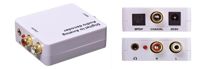

If your TV does not have a headphone output then look for a fiberoptic digital output. If your TV does have one of those (most modern HDTVs do), then you will need a converter box (also called a “DAC” or digital audio converter) that will convert the digital signal to analog RCA outputs. There’s a really basic one of these on Amazon for under $15. You’ll also need a fiberoptic digital audio cable which should be under $6 (also on Amazon).
This basic converter only supports PCM sound (not Dolby Digital or DTS), but most TVs do output PCM so it will work with most TVs. If your TV only outputs Dolby Digital sound, then you’ll need a more expensive adapter like this one for about $45.
