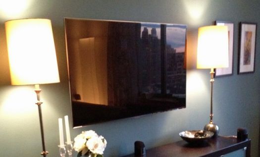

Beth likes to enjoy her movies, music and TV (“Game of Thrones, W00t!”), but when the system is off, she doesn’t want it to dominate her living space. So a big screen TV with drab styling or a large set of tower speakers simply wasn’t going to cut it. For the TV, we went with a slim sleek LED TV from Samsung, the UN55D8000 (which is now being replaced in the line with the UN55ES8000 for 2012). It’s a sleek and sexy 55-inch set with a slim bezel as well as a nice bright picture that can compete with the generous afternoon sunlight in Beth’s high rise Manhattan apartment.

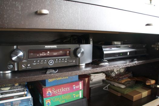

For audio and surround sound processing, we went with a slimline 5.1-channel home theater receiver from Marantz (the NR1402) The receiver has ample HDMI inputs (four), plenty of power for the space (50 Watts/channel) as well as analog video upconversion to HDMI. The analog upconversion or “transcoding” helps in case Beth wants to hook up her old school PlayStation 2 to the system for some retro gaming. She can connect it to the receiver using the old-fashioned analog audio video cables and the receiver will send the image to the TV over a single HDMI cable.

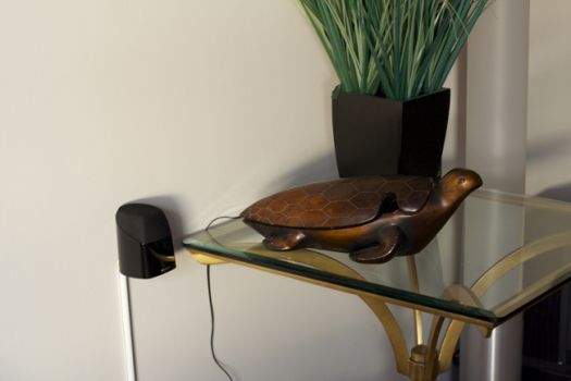

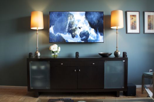

For speakers we went with the small and refined but powerful MX 5.1 system from Mirage. The little speakers measure in at just about 4 by 3 by 3.5 inches and are equally at home on a shelf, a small stand or mounted to the wall. Wall-mounting is a simple as screwing a screw into the wall and sliding the speaker onto it using the keyhole mount on the back. The MX 5.1 speakers look particularly unique with their grilles off where the omnipolar tweeter driver is exposed for all to see.
The MX 5.1’s powered subwoofer is the real surprise, measuring in at a tiny 8 inches on all sides. How could something this small sound any good? But sound good it does (we’ll get to that).

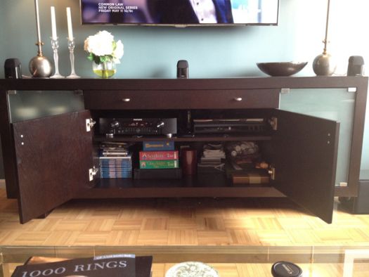

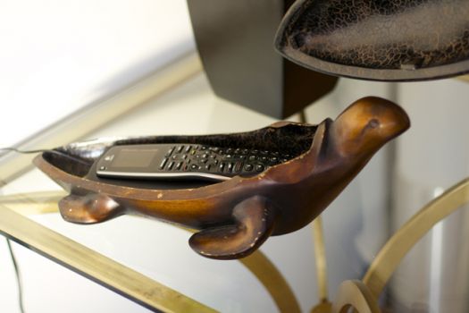

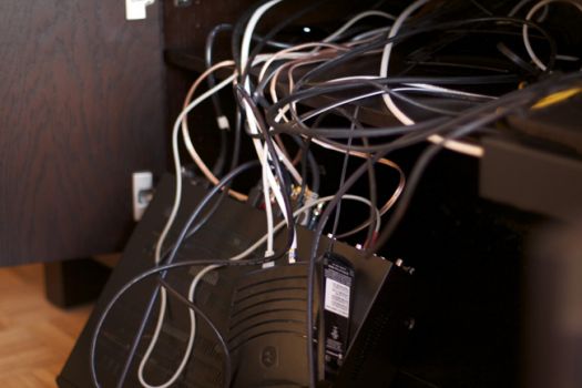

Because Beth wanted the system to be as discreet as possible, we decided to install the source components and receiver into her existing cabinet. This meant cutting a small hole in the back to route the power, HDMI and speaker cables. It also meant that a standard infrared (IR) remote control would be useless. We needed something that could get through the solid wood cabinet doors to control everything. Fortunately Beth had already picked up a Logitech Harmony 900 universal remote (an earlier recommendation). The Logitech’s RF (radio frequency) module made it ideal for operating through the cabinet, while simultaneously controlling the TV via Infrared.

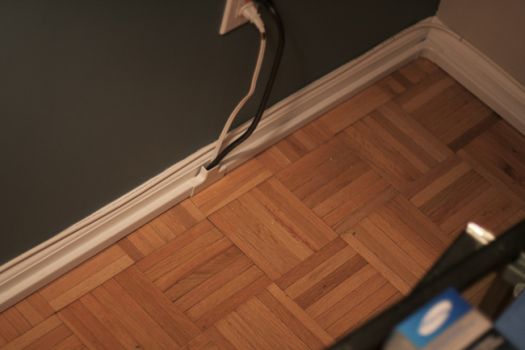

For a finishing touch, we added in an articulating wall mount for the TV. This allows Beth to easily angle the TV toward the kitchen or toward the couch depending on her viewing needs. We also threw in some cord covers by Wiremold which allowed us to hide away all the speaker wires and power cables discretely along the molding and up the wall to the rear speakers.

With the TV already wall-mounted by her building’s handyman, the rest of the set up was fairly painless. We routed the HDMI cable behind the wall for a nicely finished look, cut and stripped speaker cables, routed power cables through the newly cut hole in the back of her cabinet, and connected the HDMI cables and speaker cables into the receiver. Because the receiver handles all the audio and video switching we just needed a single HDMI cable between the receiver and TV to get all the devices connected to it. We then tweaked the activities on her Harmony remote to accommodate the new receiver and source components, I did a spot check of the speaker levels and then we were ready to sit back and experience the system. (“we” being Beth, Big Picture Big Sound movies editor Joe Lozito, his wife Jen and me).

Picture quality on the Samsung without tweaks was exceptionally detailed, but had some issues. Watching the classic “Casablanca” on Blu-ray we noticed picture details we had never seen before in the film, but sometimes more than we wanted. The picture’s excessive brightness and hyper sharpness made flaws in the set stand out while imperfections in the make-up drew a bit too much attention to themselves. The whites were a little too blue, giving the image an excessively stark and harsh look and motion looked unnaturally smooth and video-like.
A trip into the picture menu, switching over from “Standard” to “Cinema” mode and reducing the sharpness and contrast controls a bit, dialed in the color temperature much closer to accurate, with a welcome warmth restored to the whites. Black levels were also much deeper in Cinema mode without losing too much shadow detail. And by turning off the Samsung’s motion smoothing effect, natural film-like motion was restored to the moving image. Lesson learned? Brighter is not always better, and it’s helpful to experiment with your picture settings (or better yet, get the set calibrated professionally). A quick 3D sampling of “Avatar” on Blu-ray 3D highlighted the set’s strengths – a nicely bright and detailed image with excellent color saturation and shadow details, even in 3D mode.
