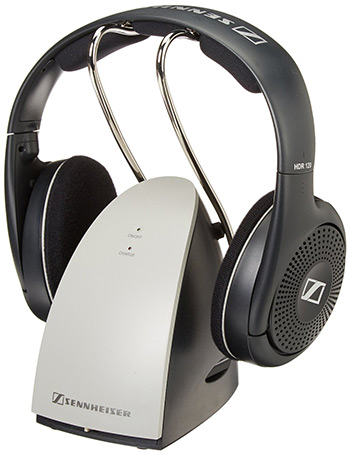

If you’re trying to connect a pair of headphones to your A/V receiver wirelessly, we’d recommend a standard pair of RF (Radio Frequency) wireless headphones instead. The Sennheiser RS120 are one example of this type of wireless headphone that we’ve used extensively, but there are many other options. RF-based wireless headphones typically have a pair of RCA jacks as input. Sometimes they’ll have a standard 3.5mm (1/8″) headphone jack instead. In either case, you can connect the receiver’s headphone out jack to the wireless headphone transmitter and that will transmit sound to the wireless headphones.
The only drawback to this approach is that plugging anything into the receiver’s headphone output jack will usually mute the speakers. So if you want to listen to headphones while still allowing others around you to hear the same material or something different, then you’ll need to connect the headphones a little differently.

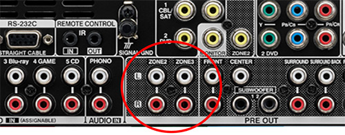

Most A/V receivers still have an analog tape loop (tape in/out) as one of the inputs. The “tape out” or “record out” jack gets sound from whatever device is selected on the receiver. So if you connect your wireless headphone transmitter to the “tape out” jack, you should be able to listen to whatever source is selected on the receiver. If you want to listen to a source that is different from what is playing on the main speakers, then check to see if your receiver has a “Zone 2” output which is not in use. Zone 2 is normally designed for multi-room speaker systems, but you can also use it to drive a pair of wireless headphones. With this approach, you can select what you listen to on the headphones independently from the main system: you can listen to the same source or select any other connected source.
The only caveat here is that on some receivers the only sound sent to the tape out or zone 2 output is from devices connected to the receiver using analog RCA cables. Devices connected via HDMI cables might not be converted to analog for the tape out or zone 2 jacks. If that’s the case then you can always connect these devices (e.g., Blu-ray player, DVD player, TV or cable box) to an unused analog input on your receiver and select that for your Zone 2 output.
