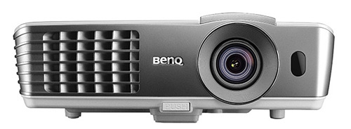

The BenQ W1070 projector is a single-chip DLP model with two HDMI inputs, PC and composite video inputs, Full HD 1080p resolution, a rated brightness of 2,000 Lumens and 3D capability. It offers nice color accuracy and great black levels, but can create that RBE which some people find annoying. It uses DLP-Link glasses for 3D which can be a little larger and more expensive than the newer Bluetooth/RF 3D glasses. It offers limited zoom (1.3X manual) and no lens shift. If you have any trouble finding it, the newer HT1075 is similar but with higher brightness (and a slightly higher price tag).

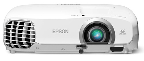

The Epson Home Cinema 2000 is a 3-chip LCD projector with two HDMI inputs, PC and composite video inputs, 1080p resolution, 1,800 Lumens of brightness and 3D capability. Its black levels are very good though not as deep as the BenQ. But because it’s a 3-Chip LCD projector — and not single-chip DLP — you won’t get any rainbow effect. The Home Cinema 2000 offers very limited zoom (1.2x manual) and no lens shift. This projector is very inexpensive right now (under $600) and is compatible with low-cost universal RF 3D glasses (under $20/pair for the latest pair from Samsung) so it offers excellent value. BPBS co-founder Joe Lozito and I each use a Home Cinema 2000 projector for our backyard movie nights.
The main drawback to these two projectors are that they have limited zoom range and no horizontal or vertical lens shift. This means you have to place the projector at a very specific location relative to your screen. The projector has to be on a direct line with the horizontal midpoint of the screen and the vertical placement requirements are also pretty rigid.
In the case of the Home Cinema 2000, I did a ceiling mount for it and found that the projector had to be almost exactly 9″ below the ceiling and about 8-10 feet from the screen in order to fill my 92-inch screen with a squared-off image. You can read more about that in my review of the Epson projector mount. If you’re just projecting against a blank wall, or haven’t installed your screen yet, then this won’t be as critical but I had to hit a specific size screen that was already mounted on the wall. There is some digital keystone adjustment to square the image off vertically if you need that, but then you lose some resolution. Similar placement requirements apply to the BenQ.

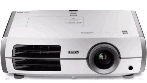

If you think you’re going to need this flexibility and still want to keep the price down under $1000, I’d recommend the Epson Powerlite Home Cinema 8345 or 8350. Each of these has a 2.1:1 zoom lens as well as a generous amount of lens shift, both left/right and up/down. This should allow you to place your projector on a shelf on a back wall a little off-center from the screen and still get a perfectly squared off picture (assuming your room is not too large of course).
To make sure you are getting the right projector for the job, we’d recommend using the excellent throw distance calculator tool on Projector Central’s web site. With this tool, you plug in your desired screen size and projector model, and the calculator shows you the full range of throw distance (distance from projector to the screen).
Both the 8345 and 8350 offer 1080p resolution, 2 HDMI inputs plus PC and composite video, 2.1:1 zoom and flexible lens shift options. The 8345 offers 1,800 Lumen brightness and 25,000:1 contrast while the 8350 is rated for 2,000 Lumens and 50,000:1 contrast (though these numbers are manufacturer-provided and should be taken with a grain of salt). But neither the 8345 nor the 8350 can do 3D. The 8345 is available for under $800 and the 8350 is currently about $100 more.

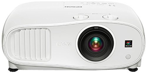

If 3D is important to you and you want to stick with a 3-LCD projector that has a zoom lens as well as lens shift, then you might have to spend a bit more to get something like the Epson Home Cinema 3000 (currently $1150 on Amazon). This one offers a whopping 2,300 Lumens of brightness, wide lens shift, 2 HDMI ports, PC and composite video inputs. It uses the newer 3D RF glasses that you can pick up for under $20/pair. Its zoom lens is slightly less powerful than the 8345 or 8350 (1.6:1) but this should still offer a fairly wide range of throw distances.
