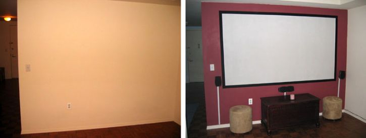

The only benefits of projecting your image on a wall are that a.)it’s cheap and b.)it’s convenient. But there are many more drawbacks. Unless it’s a spefically formulated type of paint like Screen Goo, the optical characteristics of wall paint are far from ideal. Matte paint may absorb too much light while gloss or semi-gloss paints may reflect too much, leading to uneven brightness or “hot spots.” Also, if your wall is not a neutral color (white or light grey), then your colors will be inaccurate. Lastly, any imperfections on your wall (like bumps, waves, paint drips or holes) will stand out like a sore thumb under the glare of a projector’s lamp.
The biggest upgrade for a projection system is to use a real, high quality projection screen instead of a wall as the screen. Not only will you get a nicer picture with better color accuracy and more uniform brightness, but the black frame around the edges of most projection screens will help the image to pop more by improving the perceived contrast.
